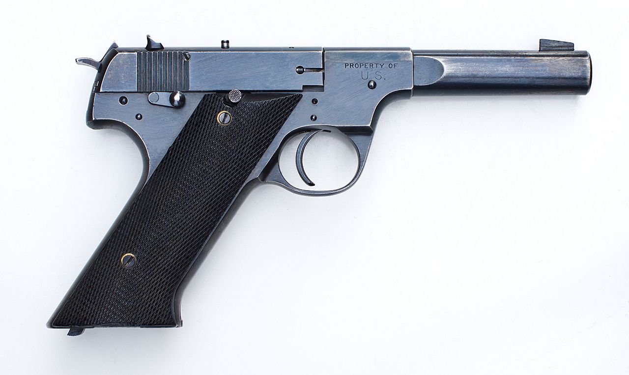

I have a Model B High Standard that my Dad had for many years. 15,000 were purchased by the government, allegedly used as training pistols. This pistol has a "Property of US" stamp on it and below that is symbol of crossed cannons in a circle (not real clear as the stamping is uneven with about one-fourth of it barely stamped).
This gun has been shot a great deal since the '50s but is still about 90%. I presume all of these were sold as surplus after the War.

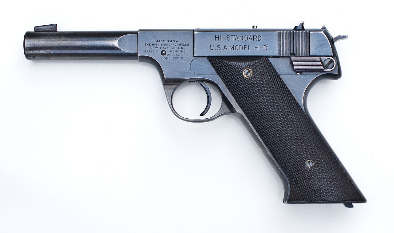

The 1960's-70's "Military" marked High Standard pistols were so designated solely on the basis of having been designed to mimic the feel of the Colt M1911 in the hand, as opposed to the prior slant grip models. One of the early slant grip models, the H-D, was (with a safety added to conform to the contract specifications) supplied to the armed forces during WWII, being marked "U.S.A. MODEL H-D". After the war, High Standard added an adjustable sight and sold these commercially as the "MODEL H-D MILITARY". The even earlier 1930's type Model B was also procured by the government during WWII, both in its original form and in a slightly modified version. Attached is a photo of U.S. Navy WAVES (Women Accepted for Volunteer Emergency Service) on the firing line with Model B's.

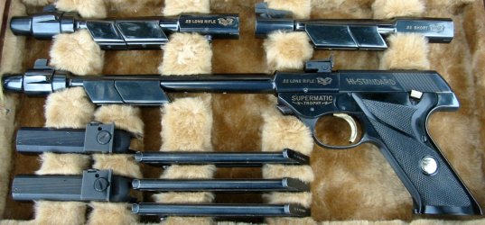

Here’s another Supermatic Citation marked Military. Very accurate target pistols. Original magazines are getting harder to find.
If you find a nice one that hasn’t been used up shooting bullseye they can be a great buy.

This is the original U.S.A. Model H-S High Standard as issued during WW II. These served as training pistols and some were issued equipped with sound suppressors for clandestine purposes and as "hush puppies" to take down guard dogs.
The number is probably a little less that 13,000.

THere were a few WWII era pistols sold to the govcernment that did not recieve the Ordnance wheel.
After WWII fes if any High Stadanrd purchased by the government had the Ordnance wheel stamp.

Lever letter Supermaitc 6.75"
S-100 Supermatic 6.75"
S-101 Supermatic 6.75"
O-101 Olympic 6.75"
Supermatic Citation 102 Series 6.75"
Supermatic Tournament 102 series 6.75"
Supermatic Trophy 102 series 6.75"
Olympic Citation 102 series 6.75"
Supermatic Citation 103 series 6.75"
Supermatic Citation 103 series 5.50 "
Supermatic Tournament 107 series 5.50"
