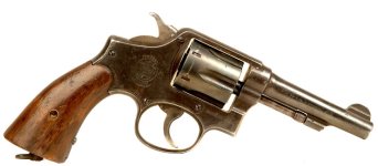

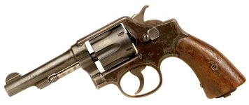

Just acquired a Smith & Wesson Model 10 I think!
Serial number V 503xxx, with the following markings:
U.S. PROPERTY G.H D.
'Flaming Grenade'
38 S & W SPECIAL CTG
Also has a Boyt holster.
Any info about date, which service it was used by would be gratefully appreciated.

It is a Victory Model, made in 1943. It is not a Model 10 - those did not start shipping until 1958, and there were significant engineering changes that were made during the intervening 15 years. You can think of the Victory model as an ancestor of the Model 10, but it is not really the same gun.
The flaming bomb is an ordnance mark. GHD are the initials of the supervising officer at the Springfield District procurement office during the war. His name was Guy H. Drewry. You can search this Forum for more information about him.
As for which service it shipped to, you would have to get a factory authentication letter to know that for sure. But most of these went to the Navy.
I list V5014xx as shipping in 2/44. The U. S. Navy was the major recipient of most of the military Victories in .38 Special. Commonly used as a Naval aviator's sidearm (but of course they were also used by other Naval personnel). Up until about V264000, Navy Victories had the "U. S. NAVY" stamping on the topstrap, and are worth a bit of a value premium with that marking. It's called a Flaming Bomb, not a Flaming Grenade. Virtually all military Victories have that stamping. Your holster might be interesting. Shoulder or belt?

It looks like there is a small cylinder/barrel gap problem there. Can we see some pictures of the forcing cone?
Sorry guys, I should have mentioned that I am in the UK and therefore the pistol has been deactivated, hence the missing forcing cone.
Barrel has also been plugged and firing pin removed.
