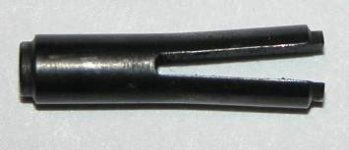

I see the pin must be out of stock at gunpartscorp. Maybe you can use a roll pin as a replacement.

Did you find a pin yet?
I don't know how handy you are or what you have available for tools, but it looks like it would be easy enough to make the pin out of a 5mm bolt.
Diameter of the pin is 5mm; overall length is 25mm; 1mm of each end is turned down to 4mm diameter; 15mm of one end is split with a 1.5mm wide cut and the ends spread apart slightly.
If you haven't found the pin yet and fabricating one is not in your wheelhouse send me a PM, I can probably fix you up with one.
