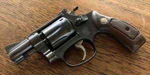

Hello all,
I am relatively new to this forum, but enjoy reading the many informative posts I find here. I recently decided to begin collecting a few Model 34 kit guns. I have found a few I am considering, but one of them is interesting and I hoped someone here could educate me about it.
This particular gun has Mod 34 stamped into the frame side of the yoke hinge (not 34-1). As I understand it, the Model 34 was manufactured from 1957 to sometime around October 1960 using the "I" frame. Beginning in late 1960, the gun was produced using the "J" frame and renamed the Model 34-1.
What confuses me about this gun is that the serial number begins with the "M" prefix. It is my understanding, the use of the "M" prefix did not begin until sometime in 1969.
So, my question is this. Is it possible to have a Model 34 with a serial number with the "M" prefix? My understanding of the dates doesn't make this seem possible, but I'm sure there is an explanation for this. Apparently, my logic for the timing is flawed. I would appreciate any guidance someone can share to clear this up for me.

The M S/N's started in 69-71, with M1 - M30000. Then continued on through M219801 and includes the 34, 35, 43, 51, and 63.
The "22/32 Kit gun" (originally a "I" Frame) Model of 1953 was introduced in 1935 and went through several changes before 1957 when the Model Number 34 was assigned. There are some extensive history information on the Forum, do a search under 22/32 Kit guns.
Welcome to the forum you will find much information and discussion on one of S&W's finest .22 revolvers.
Measure the cylinder length and report back. That is the best way to easily determine if it is a J frame and not an I frame. Everything you have reported so far would seem to point to a 34-1 that was misstamped. But the length of the cylinder will end any debate.

Welcome to the forum. And bravo! No one could say that you didn't do your homework!
Tonight is the first and last lesson with regard to S&Ws:
"THE MAIN RULE IS, THERE ARE NO RULES!"
The more we learn about them, the more we find anomalies that don't fit the facts. In other words exceptions abound.
You experienced one of them, the miss-stamping of dash #s. We also see miss-stamping of the Model # itself but not near as often.
I have one exactly like the one you saw. Always go by the serial # and the one on the butt. That's not to say they haven't been mis-stamped as well, but that's much more rare.
With as many as I've seen, the Model 34-1 had a particular problem leaving off the -1. I believe it's more then a simple miss-stamping, usually a 'one off' problem.
I suspect it was a multiple miss-stamping issue, perhaps a whole days production or more, maybe a Monday or Friday. Either the "Mod 34-1" stamping die was miss-aligned in whatever jig was used to stamp the frames, or the -1 broke off the die and no one noticed, etc. Because although there's enough room in the yoke for the full stamp, it's just positioned too far back in most cases, which drops the -1 off the rear edge of the yoke.
The problem seems to cluster around the '69-'71 period But that's all I know about it. The serial #s don't matter because I'm sure you've read enough to know that neither S&W's production or shipping corresponds to serial # order.
So as Jack said, the length of the cyl to ID an I or J frame is foolproof, and there's quicker ways to tell at a glance that will help you in your hunt for .22/32s.

Hondo thank you for the excellent tutorial of the M34. I'm learning also and would like to know what your referring to as a flat latch?
Jim posted this picture in his earlier post. Look at it again. The Model 34-1 (4" nickel) has the conventional thumbpiece. The Model of 1953 (2" blue) has the flat thumbpiece, also called a "flat latch."
