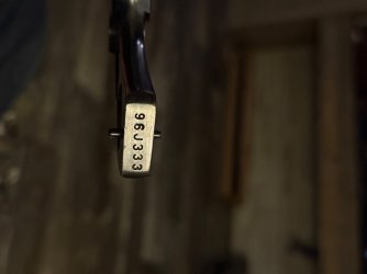

Recently purchased a Model 36 round butt (no dash), wanted a summer "hideout" gun that I wasn't afraid to shoot or get dusty.

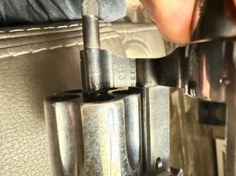

Anyway, the serial number is 96J333 stamped on the butt. Anybody know what the two digits before the J are for? I have a Standard Book of S&W, I've got a few Smiths in my stash…just don't ever remember their being numbers stamped BEFORE the J-prefix guns serial numbers. The only other numbers are stamped on the yoke, no other stamps on the frame except the usual "Mod. 36"
Figured somebody here would know.
Thanks!
-Bobby

Hi, Bobby,
Yes, several folks here know.
Smith & Wesson Historian Dr. Roy G. Jinks, called that serial number series the "roving J series." It began in 1970 at serial number 1J1 and ended in 1973 at 999J99. . Sandwiched amid two to five digits, one to three digits before it and one to four after it, the J made its methodical march toward the right. Serial number 9J9999 preceded 10J1; serial number 99J999 preceded 100J1 and so forth.
Based on others in the database, I'd estimate yours shipped in 1972.
Bob
