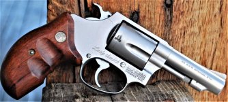

As I said earlier, the first stainless Lady Smith was the 60-3. See the photo for the 3" version. The 2" 60-3 Lady Smith wears smooth laminated rosewood stocks.
