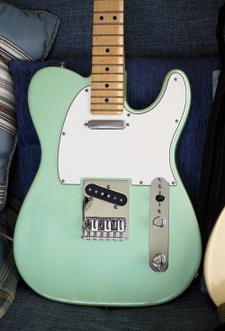

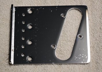

I have not gotten to polishing the frets on the Fender MIM Telecaster yet but I did sit down a couple nights ago, took it apart and cleaned it. Pictures just do not do the Surf Pearl paint justice. When you look at it from close the pearl just pops, especially now that I cleaned the layer of scunge from it. Wiping it down with alcohol soaked rag cut through it but left a lot of streaks. I had to go over the finish with a slightly damp cloth followed by a dry one to get rid of the last of it. It is unfortunate that the rust made its way to the bridge plate and the saddles, but I am planning on going a bit more vintage with this one anyway. I have a Fender marked 3-saddle Tele bridge on the way, as well as a set of as new Fender Classic Tuners that were pulled off a Player II Strat. Combine those with the new brass barrel saddles I have in my parts bin and that classic look will be complete.

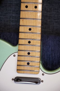

Slight update on the MIM Fender Tele. I spent most of last week helping my sister and her husband pack and load the remainder of Mom's antique/art glass collection and inventory from her and Dad's business. They left Friday morning and I have been shuffling bits and pieces from the house into the garage and rearranging things in there. Sat down last night and went to work on the tarnished to the point of looking rusted frets on the Tele. There were a few tiny rockers on the high E side of the board. A couple taps with the nylon hammer on the fret seating tool took care of them. Good job at the factory on this fretboard. Now this is what frets should look like when they are basically new.FenderMIMTelecaster6.jpg
