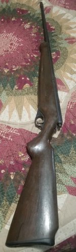

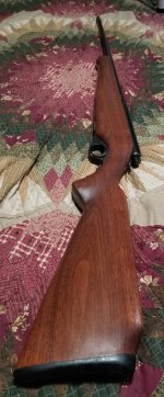

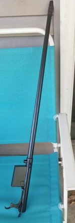

Picked this up for my nephew's son to hunt with. This model was made between 1953-1956 which I thought was neat.
This one is a 410
They have changeable screw on chokes at the end of the barrel.
This one is full which is perfect for the intended use.
It had some surface rust, a gummy action, and a very ugly stock.
I started with the metal work and in 15-20 minutes it looked new again.
Guess I couldn't just stop there.
Had to see how deep the ugly went.
It was deep.......I almost drowned
But the ugly....like beauty was only skin deep.
Here she is before and after.
Kid may not be embarrassed to walk around with it now.
