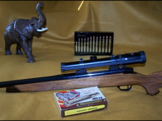

I got myself a muzzle brake for this guy.
