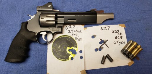

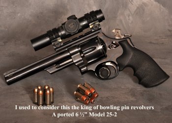

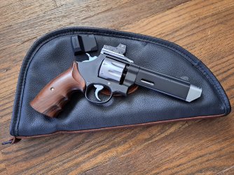

I have been shooting bowling pin matches regularly for over 25 years. I thought I had the ultimate pin gun when using a Magnaported 25-2. I was at a match with it when I broke the firing pin so a buddy let me use his V-Comp to finish the match.
I knew a lot of guys were using the 8 round V-Comp and considered it an advantage but I very seldom needed a reload so didn't consider them better than a 45 shooting 260gr RNFP.
I was wrong!
The 627 shot lighter and the heavy 38 wad cutters took the pins down as well as a 45. It didn't seem logical but it works.

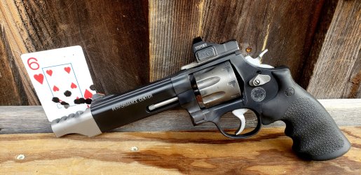

It took me a while to find a reasonably priced new one during the summer of mostly peaceful protests but when I did I developed a 230gr WC load for it, got a custom compensator, smoothed out the internals and lightened the springs. It is now one of my best shooting revolvers ever.
I use Federal, Remington and Starline 38 spl. brass with .025 clips.
I think if you are looking for a long barrel racing revolver and can live with the new style black finish it is good right out of the box. If you tune it up a little it is great!

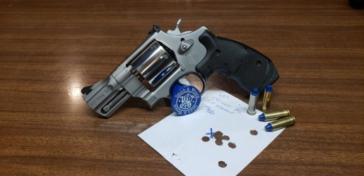

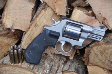

I also have it's little brother that is my favorite 357 Magnum ever.
