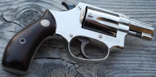

Here's a 4-screw: nickel '54 Chiefs, and
a 3-screw: blue '57 Chiefs Airweight

The sellers pics are not too good. I blew up the right side pic and still cannot tell if it has a screw by the hammer but I think it does. Anyway it seems to be a '56 and I'll probably see it this week. When did these change to 3 screw? Here's a pic if the left side, If I buy I'll post better ones.
