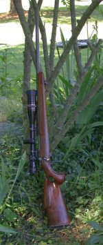

The 1500 was made by Howa of Japan, very well built and accurate rifles. Seldom see one chambered for .223, they bring a premium, I only have one that is chambered in .240 Weatherby Magnum, that thing can shoot. Grab that .223 if you can, you will like it.

I wasn't specifically looking for .223, but ended up with the Standard 1500, Deluxe Varmint and Mountaineer all in .223, while my Deluxe is a .222 Remington.

From the picture then the one soon to be mine is heavy barrel varmit.
If it is the heavy barrel varmint, that is worth another $100 or $200 in my opinion.
