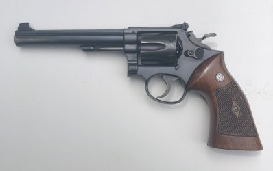

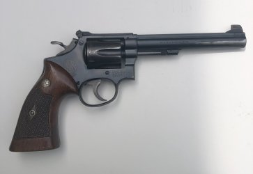

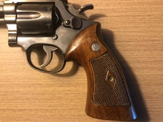

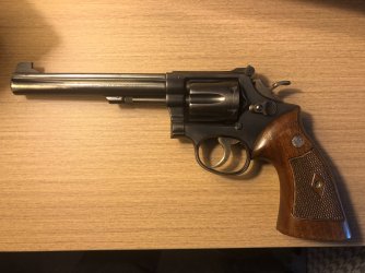

Hello Forum, I am way out of town and away from all my gun stuff for a week but wouldn't you know it...a chance stop in a off the path small town pawn shop to check on a guitar in the window and dang there is a K 38 6" blue 3T's sitting in the case at a decent price. I took some pics, some cash got me a hold on it till Monday, the guy will honor my C&R, no tax, no 4473....just out the door. It has been there a long while and I think negotiable a little further.
I told him it is definitely C&R as there is no model number in the yoke and S & W started model numbers in 1957, so clearly earlier than that. He is OK with that for C&R transfer but I'd like to know more from you folks that have your 5th edition of SCSW close at hand. The serial number is K 92692, numbers match on cylinder and barrel flat. Will pull grips to check butt but assume match. Big wide checkered target hammer, serrated trigger, diamond checkered walnut grips, square notch adjustable rear, Patridge ramp front. 6" barrel, bluing loss on high spots and both sides of barrel towards muzzle. Action locks up tight, no end play, no push-off, bore is crisp and shiny.
Questions: I'm guessing 1951 shipment, maybe earlier, would one of you with SCSW close-by just let me know what it shows for that serial number assignment year?
More questions are about the correct nomenclature and accessories. Would this be known as a K 38 Masterpiece as the K 22 Masterpiece of the post WWII times are known? I believe they were sold in those days as very close in weight for target shooters. What is the correct box? I have a blue/silver two piece but it is Bangor Punta and labeled for a Model 14 so not period correct. What tools would a K 38 have shipped with? What would be the proper dated instruction manual or parts list?
Thanks in advance for your help with this gun. I'm pretty much a sucker for these old diamond grip wheel guns and I will probably take a flyer on this one on Monday when the guy opens again, but would appreciate any further id help I can get.
Cell phone pics below

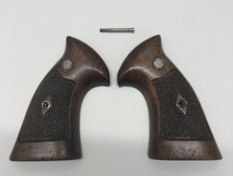

From the K frame database, I'm seeing serials around that shipping mid-1950. It was called the K-38 Masterpiece and shipped in a gold box with a black 8 or 9 row knurled SAT, cleaning tools and paperwork. The non-relieved targets were not standard and likely were made later. Would have shipped with sharp-shouldered magnas, probably.
Yes. It is a K-38 Masterpiece, but at that time it would have been called a K-38 Heavy Masterpiece because of the barrel profile. It probably shipped late in the year 1950. K93203 is also K-38 Heavy Masterpiece, probably from the same production run as the one you found.
The target hammer is probably original, since they became available in 1950. The same is true of the non-relieved target stocks.
Your Bangor Punta box is much later, not earlier than 1965. The revolver you are looking at would have shipped with a gold box, a Helpful Hints brochure, cleaning tools and a Sight Adjustment Tool (small screwdriver).
The unit looks good. I'd be a buyer if I were you.
Almost certainly a 1950 ship year. The Heavy Masterpiece was introduced in in 1949 -K76XXX sn range, but narrow rib barrels were shipped all the way into 1953 - K157XXX sn range. Your revolver does have a heavy barrel that matches the weight of the K 22 Masterpiece revolver. Target hammer and stocks that were first introduced in January 1950. I have no notes on when the target trigger was introduced, but your gun does not have the third "T".
If it were to letter as having been shipped with those target stocks, that would make it pretty special.

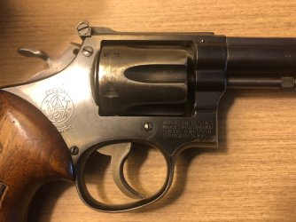

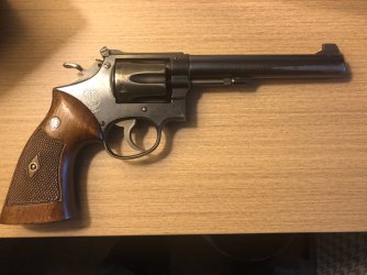

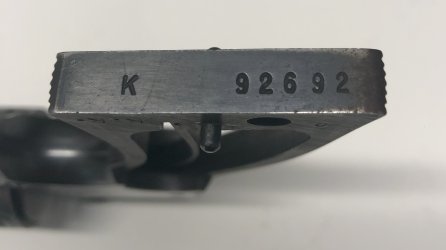

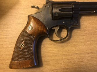

Well went back last Monday morning, looked it over again, still looked righteous and I had "cheated" somewhat, knowing I was going to buy I asked over on the SWHF for a ship date and Mike Helms came back with September 1950...right smack on the money. Travelling back home but got to pull the grips and take some more pics and found some neat stuff.
It is clearly a K 38 Heavy Masterpiece although there is only scant info in SCSW 5th, about a "Heavy" version. I did find the unrelieved Target stocks and the deep checkered wide spur hammer to be factory options for the year 1951, so am doubtful my gun which shipped in 1950 had the traget stocks originally, but it could have shipped with the hammer as this was available. My source?? An old (very old) gun mag from 1951 showing and describing the K 38 Heavy Masterpiece ($71.00 retail)!
So definitely a K38 Heavy Masterpiece, with square butt, factory target stocks, 6" pinned barrel, all numbers matching, square notch adjustable rear, Patridge front, serrated trigger, wide spur hammer, narrow rib....September 1950 nice gun.

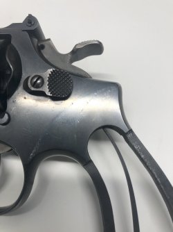

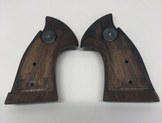

Some pictures show the infallible proof that the target stocks did not ship with the gun, but someone put them on years ago...long ago enough for tow "tracks" of marks to appear on the frame...one "row" of tracks exactly resembles sharp shoulder Magna's, the other depicK38-LEFT SIDE.jpgK38-RIGHT SIDE.jpgK38 GRIP MARKS.jpgK38 GRIPS BACKSIDE.jpgK38 GRIPS FACE.jpgK38 SERIAL NO.jpg1951 gun book 2.JPGts the exact placement of the current Target grips.
The action is really great with a crisp, steady trigger pull in DA, and a real decent slight squeeze crisp let-off in SA. Of course that's dry firing and lead nose ammo is banned at the indoor range I frequent so I'll have to check stash for some jacketed or semi jacketed rounds and get her out for some exercise soonest possible.

If I am not mistaken, it was pretty common that dealers had target stocks on hand and would swap them out for customers. Possible that is what happened in your case.
S&W target stocks were sold in blister packs at almost all hardware stores shortly after they were released. No hand-fitting required with these stocks. I have only read references to targets being numbered, but never seen in person.

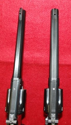

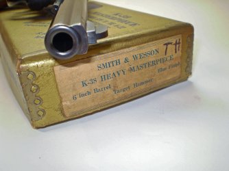

I do not know exactly what the question is above, but you do not call a narrow rib K38 a Heavy barrel Masterpiece. Not only is the rib wider, but the barrel has a larger diameter. They did not have their own gold box, but rather a glue-on label.
Let me add that company flyers also listed both types in the early 1950s.
The rib on the K-38 is narrower than the one on the post-1950 (or so) K-22, but broader than the one on the tapered barrel K-38 IIRC. I can pull all three out of the safe and check if you need me to.

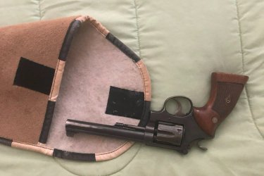

Below pic shows whatever it is.....your guess is as good as mine. Never saw one before.

I have a couple gun rugs like that one. Bought several of them from a vendor when we were doing gun shows in Virginia a few years ago. Don't know who made them but they came in a couple different sizes, would hold a variety of different handguns.
