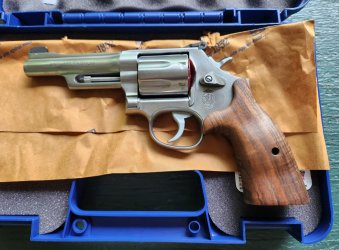

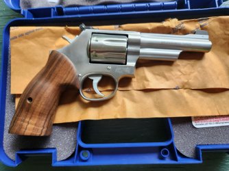

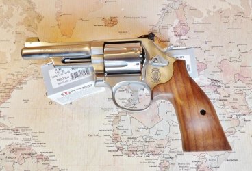

Just awhile ago, unfortunately I had to pass on my
Lipsey's new 2025 S&W Mdl 686 Plus Mountain Gun
357Rem Mag 7 shot.
Way too many blemishes;
Front Sight bluing thin on left side.
Machine chatter marks around each inside
edge of front cylinder chamber holes
(Star extractor lift teeth ok, fit well done).
Two polished looking dimples on right edge
of receiver plate by hammer.
Unsightly radius buffed groove on barrel rib.
Grips one dark side and one lighter side.
Grip fit touching all frame excellent and bottom too.
Screw second one down by grip bugered up.
Business card slipped in Yoke/crane and frame gap.
No inconsistency in frame/barrel polish.
Rear Sight centered, nice finish.
Muzzle well finished. Very sharp edges on
forcing cone end.
357 cartridge billboard roll stamped in,
Mountain Gun billboard lasered on, cheap.
Barrel/cylinder gap appears very tight but
one side minute wider than other.
Trigger inside edge dinged up.
Trigger pull SA very nice, smooth, glass
break. I don't do DA ever.
Very obvious Quality Control is lacking. Very
disappointed in this first one. Hope my next
one, I can take home.
