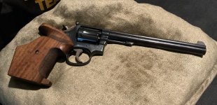

Hi,
I thought I’d share something y’all don’t see everyday.
I just got a nice Karl Nill UIT target grip (left hand!), made in Germany. Here’s how it looks on my 14-4 with 8-3/8” barrel.
I think they look and feel great, even if the barrel length exceeds UIT Centerfire Match regulations.
These Nill grips are renowned for their ergonomic design. They really help with a steady hold on these long barrel S&Ws!
(Sorry for the grainy third photo. It was a bit tricky to hold the gun and take the picture at the same time!)
Thanks to my good friend Peter, and fellow forum member, “P.44”,
for facilitating the deal on the grip and getting it across the Atlantic!

Nice, although I'm not familiar with those grips. I'm taking my 8 3/8 14-3 out for some exercise today but I'll have to get along with the S&W target stocks that are on it.

An interesting design feature of the Nill grip is that it gets the web of your hand as high as possible. The bore and line of sight is closer to the top of your hand. This assists balance and recoil control.
Since the hand sits so high, you can see in the attached picture that the top of the grip has a recess cutout to allow for the hammer spur!
The last picture shows the adjustable palm shelf.

Nice! that's almost a Hammerli now!
My Hammerli 160 free pistol also has a Karl Nill grip. ;)

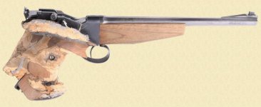

Quite often, when a used free pistol is offered for sale, there’s hardly any wood left. Just a hacked up skeleton covered in wood putty, epoxy, foam, cloth, etc.
It can really take a neophyte by surprise!
The attached picture will probably make your cringe, (or worse!)
