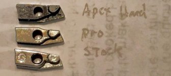

If the attachment uploaded, you can see the differences in the sears; stock, Pro Series and Apex Hard Sear. The profile on the Pro and Apex are quite similar, but the underside of the Pro sear is relieved for some reason. I could not get the Apex to perform to my liking in the Pro Series M&P with and AEK trigger. So after about a year, I switched back to the Pro Series sear and kept the AEK trigger.

Good to know. I got the Apex Comp AEK to install later. Ill try it with the pro sear first and go from there
