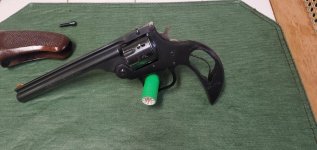

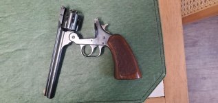

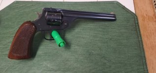

New To Me H&R .22 Revolver
That's one of the good ones built in Gardner, MA. Nice .22 revolver. Thanks for the look. ;)
