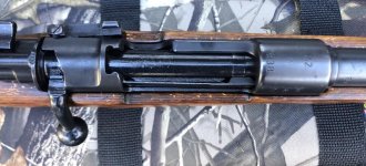

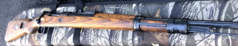

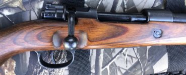

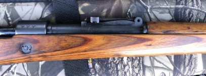

Bought my first Mauser K98 with the goal of understanding the rifle and then shooting it too. This is a RC Oberndorf stamped 1938 42, no front sight hood and no front sight hood grooves, receiver and barrel match 4702, the rest is mixmaster. The rifle had a thick and tough coating all over stock and parts of action, black oxide butt plate, yellow coating on take down disks with some rifling showing in barrel and a defined looking throat, maybe not a bad project. Has 1 cross stamp from russia capture, NZ symbols peened out but no e-stencil force match. Was imported by Century in VT and has their stamps and 8mm stamp right behind front sight. I assume they headspaced and it's good to shoot, cycles the ammo fine. I dont care for Russian capture authenticity, I wanted the rifle to look the way I like to see it close to what it may have been.
Anyway: 1st things 1st: Remove that shellac. Alcohol, acetone, paint thinner.....no flinch from the yellow coating, maybe someone slobbered urethane on it years back...anyways: I started and it had to finish: Chlorinated paint stripper, 15 minutes, scraping, multiple times, there it went, the stock underneath was pretty oily and I saw no signs of delamination to the red glue stock, all good, then a hot bubble bath in Murphy's soap, lots of yellow and brown crud coming out, did not want more heat or steaming out dents, I wanted the rifle still to show the eastern front action character it has. Drying the stock a few days, sanded 320, 400 blocks, BLO soaking, rubbing, finish between rubs w 600 paper and voila....absolutely love it.
Barrel...I could see some groves in there but typical sewer pipe look, soaking in hope's first, lots of bore brushing, huge amounts of dark brown gunk came out, took the copper w Hoppes benchrest, got frustrated how much more dark soot came out after every bonze brush run, after a few days I gave it a few runs with a tight patch on a brush and JB bore paste, I see pronounced clean rifling now and the bore feels smooth as some of my best rifles, all copper is out, I stopped there and now shooting it soon.
Russians gave the action a deep back oxide coating which I flizzed a little to make it look more like original bluing. I like it now just the way it is, probably will buy more K98 as I come across them but anyway, this was my first, will post some groups here shortly.

Congratulations on your first. Nice having a pre-war example. Bores can be a challenge as left uncleaned for years. Don't believe early guns came with a sight hood. Had a BYF 44 imported by C.A.I. myself way back. Stamped up front on underneath of barrel. Prices have really shot up on R/Cs lately. Thanks for sharing.
Looks great! I bought a Yugo 8 mm Mauser in similar shape from a pawn shop about 12 years ago for $89.95 with all matching #s and did a quick sanding and refinish on the wood with Watco and it was a heck of a fun shooter. Sold it for a big profit but that money seems insignificant now, sure wish I had the gun back.
You did that 42 code 1938(Mauser mfg) justice. Did you take any before pics?
I all excitement I forgot to take pics before, the goal was to remove all russianization as much as possible while keeping the character it had. I am happy w it and will shoot next Sunday, today the day ran away.
