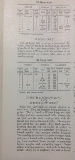

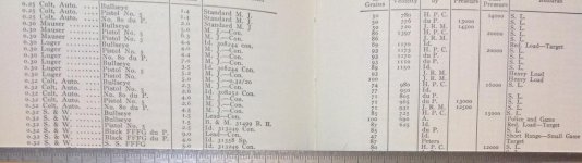

Lyman #38 Data
Here's some "period correct" data by Phil Sharpe. I've attached info for the various short and long Colt and S&W cartridges.

PS: I added two pages of load data from "Pistol & Revolver Shooting" by Abraham Himmelwright, pub. in 1923. .32 S&W Short is referred to as simply .32 S&W. He designed a few molds for Ideal and Belling & Mull, so he references bullets according to their mold numbers. The first page shows just the loads. The last image is spread over two pages, but includes a little more info on the bullets, and velocity. Nice to see the inclusion of black powder loads!
Both Sharpe and Himmelwright seem to be in agreement that for your chosen bullet weight range, 1.4 to 1.5 gr of Bullseye would be a max. standard pressure load.
