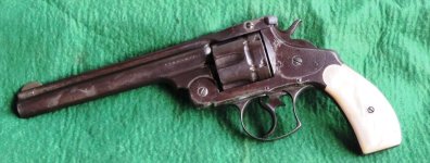

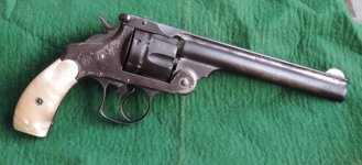

I'm in the process of abrading off the last tiny bit of nickel plating left on a S&W 1st. Mod.DA. Only about 10% or maybe a little less of the plating remained when I got it so I opted to just use successively finer abrasive paper to get it down to send out for reblue. I'm almost there. I did email inquiry of two local plating places to see if they'd do the reverse electrolysis and neither had the courtesy to reply which I thought was somewhat impolite. The pistol was very ugly when I got it (see pic). Good luck to you.
