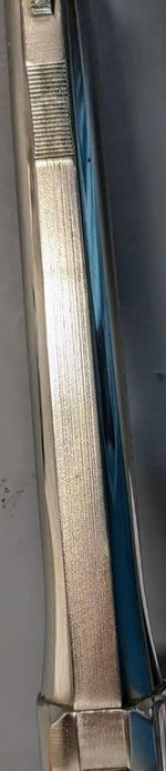

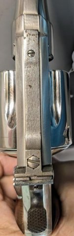

Although I’m nowhere near being an expert, a friend asked me to go with him to a LGS and check out this revolver.
I told him that I had never heard of a nickel-plated Model 28 Highway Patrol, but I took a quick look at the latest edition of the Standard Catalogue before we went. There, I found out that some were made for the Florida Highway Patrol and just a few were made in brushed nickel.
When we got there and I saw it, I quickly got the impression that it is an after-market nickel finish, and I told my buddy. But I also told him that the best way to find out is to get a letter of authentication.
The owner was very gracious and he let me take some quick pictures that I’m posting here. Forum, what is your opinion? Thank you!

BTW, three numbers stamped on one of the stocks does not match the serial number. And the extractor is not nickel plated.

The revolver has case-color hammer and trigger, which are present on factory nickel guns. There should also be a blued extractor star on a factory nickel gun. The rear face of the cylinder would have a stamped "N" between two of the charge holes at the edge, and the frame would also be stamped "N" on the left side of the butt frame. The SN puts it in 1979 production. SCSW doesn't mention any LE special orders in that time frame, but it could have been a private special order. There was a rather large NYSP order of M28-2 around that time frame, but they were all standard blued 4" revolvers.
I base the build date on my M520, which has a N558xxx SN and it was manufactured in late 1979 or very early 1980 (prior to February).
Thank, HT. Yes, the hammer, trigger and extractor star match what the colors you describe. I could have missed the N on the rear face of the cylinder (sometimes is lightly stamped), but the only marking on the left side of the butt frame is what you see. BTW, does the S/N above the model number look unusual to you, or is it just me?
The serial number is too late for one of the Florida HPs, and the dished screw holes on the sideplate and rounded edges elsewhere point to an aftermarket refinish. It would be interesting to see if the cylinder is stamped 'N', or if it's stamped to indicate a return to S&W...
I have a 28-2 that's nickel plated. I believe it to be an after market job. It's an extremely nice job, done by somebody who knew what they were doing. Model 28's are fairly common. no rare collector's item. I think a really well done nickel job might be a small enhancement to the value. Of course an indifferent job would downgrade it.
The Florida HP purchased 25 Model 28s with a 5-inch barrel and nickel finish in 1959 (4-screw frame). The revolvers are stamped FHP with numbers 32 through 56. In July 1972, S&W shipped 54 Model 28-2s with a 4-inch barrel and brush nickel finish to various distributors. The revolvers do not have an N stamped on any of the parts. The end label on the box is marked NB in the finish box. In addition, S&W did not offer a change of finish for the Model 28.

Doc44 has spoken, he's the unarguable expert here. I don't think the SN looks odd, the numbers there are individually stamped so they hardly ever line up or look alike.
I thought they FHP guns were 5"; this looks by eyeball to be 6". Betting not factory.
FHP guns are much earlier and have a S prefix.
I think there's a chance it could be factory, but a Letter would be the only way to know for sure. If it is aftermarket, the one who plated it at least followed the S&W pattern of Case color H&T and the blued extractor star. Most would have hard chromed the H&T and plated the star too
