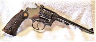

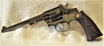

James, for your data base, if you want the info, I got this 22/32 HFT at auction several years ago. S/N 139008, butt S/N is 827 shipped to Norvell Shapleigh Hardware Co. St Louis on Aug 25 1911.

Thank you John. I have all of the serial numbers and shipping dates and destinations for the first 1,050 except a few that were not legible in the factory shipping records. What the records don't tell you is the stock imprint number or the configuration that the gun shipped in or what the current condition is.
Unfortunately, S&W did not keep track of the stock imprint numbers or assembly order number if you prefer so the only way to gather this information is by observation, one gun at a time.
It looks like your gun has the Paine front sight which would then also have the U notch rear. Is that correct? There are a few with Marble or Sheard front sights so it is sometimes hard to tell from a computer monitor. Usually the Marble or Sheard sights are so marked whereas the Paine sights are not. Your gun appears to be in very good condition.
Are there any factory return dates on the frame or any mods that I can't see? Factory box?
I try to add as much information to the database as I can but I do not keep owner info.
Thanks for the info as I did not have that stock imprint number in my files and each one helps to narrow down the story.
