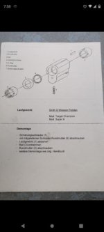

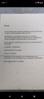

It's not permanently attached. I'll be attempting to get in touch with Kurt for advice, the take down key and replacement parts if available.

I seen take down keys are still available on his website. I don't have a way to get dimensions for the tool and other than our two guns, I've only seen one other that's in the USA right now. Im not rushing to remove it just yet. After firing 300+ rounds it cleaned right up. It took a little longer and more care to clean around the barrel and inside the front of the slide and the briley bushing area. But I'm not one to complain about gun cleaning. I enjoy it.
