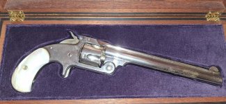

Parting with this one soon.
Model 1 1/2, 6", .32 s&w, nickel, pearls.
In very good condition. Minimal flaking and some freckling on barrel.

I'm lousy at prices but If I like what I see, that influences the price. I know there is one on GB and it has been there - like forever, because it is refinished and well over a grand. I'm not buying it.

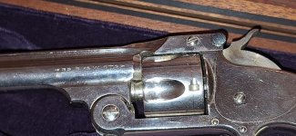

This is why it is so important to supply pictures up front. You have a model that is often mis-identified as far as I am concerned. It is not a Model 1 1/2, but rather a 32 Single Action revolver made from 1878 to 1892 in serial number range 1 to 97,574. Being an antique, you can sell and mail this one directly to a buyer in most states.
Not original

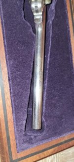

The gun looks very nice but the barrel is from a later double action. Notice the stamped caliber on the left side? That didn't happen until 1902. Also the last patent date 1889?
So it's a put together that was refinished to match the color.
Looks very nice.

The last patent dates of Jan 3, 1882 and April 9, 1889 indicate a 32 Double Action, 4th Model. The last patent date on 32 Single Action revolvers was Dec. 18, 1877, so . . .
