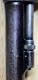

Please help me identify the approximate age and info about the life my new revolver has had.
It's a solid frame hand ejector, with no model number (only assembly number behind the yoke.
The serial number is printed in the opposite direction from what I expected. It's 88877, with no letters anywhere. It's chambered in .38 S.&W. Special & U.S. Service Ctg's, per the left side of the barrel.
Speaking of the barrel, it's 5" from the cylinder face to the tip.
It has fixed sights.
Further info, though probably not needed: it has a strain relief screw and is a 5 screw model with no Lanyard Ring.

Welcome to the Forum! That's a nice vintage M&P revolver you have. I took the liberty of flipping the pics around for you for a better look. There were millions of M&Ps manufactured over the decades, so they are not rare or particularly valuable, but these early ones are pretty cool. Enjoy!

Welcome to the forum!
The serial number reads correctly with the muzzle to right until 1942. After that it reads with the muzzle to the left.
Call it what you like. When it left the factory, it would have been advertised as a Model of 1902. All of the round butt units were at that time (until WWI).
With that serial number, it probably left the factory in about 1907.
Pretty well preserved and seems to have its original hard rubber stocks.

Collectors often get out in the tall grass when discussing nomenclature and things like "changes." All you really need to know is that you have a .38 Military, Model 1902. Its principal identifier is its rounded butt. The Model 1905 differs mainly in its having a square butt. Notice that yours has the so-called dual caliber barrel stamping. The "U. S. Service CTG" is actually a cartridge called the .38 Long Colt. It was an earlier and slightly shorter predecessor of the .38 S&W Special cartridge, and indeed it was the official U. S. Military revolver cartridge used from the early 1890s and remained in limited service even during the WWI period for some applications. It is a semi-obsolete cartridge today. As the only dimensional difference between the .38 Long Colt and .38 S&W Special cartridges is case length, your revolver can safely use both, but you are unlikely to find any .38 Long Colt ammunition today. That dual caliber barrel stamping ceased use at a serial number a little greater than 100000. A final item. S&W stopped using the 1902 and 1905 nomenclature for K-frame revolvers around 1915. Thereafter, all were called Military and Police (M&P) revolvers, either round butt or square butt.
