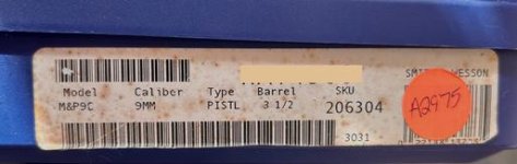

@Saudade: I did get the box and everything. Can you discern a date code from this label? (attached)

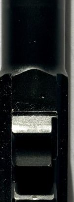

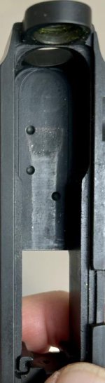

As for the barrel and slide dots, there is stuff to be seen (attached). The slide has 3 distinct large and distinct "dots" drilled in. The barrel has one tiny dot that looks like a proof punch mark (it is the white dot you see in the close up).

Yeah, the 3 (year) 031 (day in Julian) is the date code. Looks like Jan 31, 2013.
SW made a change from the 4 digit code to 6 digit (mmddyy) sometime during the 2013 year. My fullsize has a 4 digit date (Apr 2013) but my 9C has the 6 digits (Oct, 2013).
