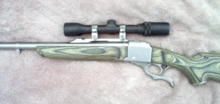

Mild to Wild 45-70
I have used (from mild to wild) Unique, Universal, 4759, H322, Varget 3031, I use a 350 g cast Ranchdog. I get 1500fps with H322 wityh Ruger #1 45-70
