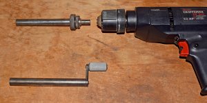

I have the manual RCBS trimmer and bought an adapter for my drill. The RCBS adaptor works but is not fixed into the trimmer it comes in and out and pivots.. The one I bought was from a guy that makes them it is a fixed adapter. I suppose you could just use a long screw and check it in the drill . I made a shelf to keep the drill level,
