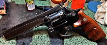

This is a target I shot with my PPC revolver last March. IIRC these were HBWC's. Have a few thousand HBWC's that I want to save for my 52. If I can get the DEWC's to preform near as well then I will be happy....ecstatic, in fact! The old beat up looking revolver is my PPC, it looked loke that when I bought it. One of the best buys that I have ever made.

My ppc revolver built from a model 10 frame. If you look at the rear of the revolver your pre-14 will have a slot for a rear sight. My frame has a rounded groove/iron sight setup.
