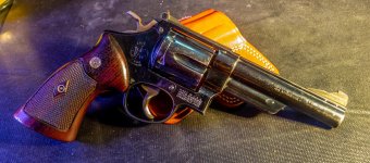

I recently acquired this Pre-29 44 mag pistol. It is a 5 screw with the Coke grips. I was an everyday carry by the original owner so it has lots of holster wear. What I'm most interest in is this a 5" barrel? If I am reading it right the Blue Book of Gun Values says there were only 2 made with that barrel length. SN is S167342. That number matches on the cylinder and under the grips. No Model number under the yoke.

Welcome! Given the placement of the barrel rollmark, the non-stock front sight and the serial number my impression is the original barrel has been cut back to 5".
Original 5" guns are uncommon but cool, which was probably the motivation for this modification.

No single person that posts here would go as far to say "Oh it's not real 5 inch so I would not want it" It is absolute cool! It may not be an original manufactured 5 inch barrel, But a letter and some research may reveal that it could possibly have been a prototype for reaction of the market who knows what was going on in 1956 but I would be calling right now Mr. Doc 44 opinion!

From what I'm reading from Doc's book there was only one 5 screw 5" 44 Magnum, and I'm pretty sure it has a ramp front sight, SN: S153748.
Still, an interesting gum.
Edit: OP's gun has the ramp , with a modified blade...I think.
Looks like H R Knowlion
That is correct: HR Knowlion. Would that be a distributor? Would the assembly number in the yoke always match the barrel number if original? The original owner was a wheeler dealer from Okoboji, Iowa. He did lots of engraving/machine work and competition shooting way back 40s-50s so he could easily have modified it for easier carrying It came in a Lawrence Floral pattern 122LF holster with belt, cowboy style.
Only slightly disappointed it's not an original 1 of 2 but very fun to shoot. Action is still like butter. Thanks everybody.

George...If you have the details about the guns you referred to, I would like to add them to my database. Currently, I know of only one 44 Magnum with a 5-screw frame and original 5-inch barrel. I originally thought there were two, but S154457 turned out to be a 1955 45 Target with a 5-inch barrel shipped to Rex Firearms on August 27, 1959.

Original or not it's still a desirable configuration of a great revolver.
I've only seen a couple of guns with that kind of front sight.
I always thought that the "sawtooth" shape doesn't look like it would be the best for a gun that is going to be holstered/unholstered very much.
Looks like it would drag/gouge the inside of the holster enough to eventually saw right through the leather. Unless you used a holster with a built-in sight channel.
Does anyone know if there is a name for this style of sight? It looks like a hybrid - half Baughman ramp, half Patridge - except that the flat rear surface of most Patridge sights is perpendicular to the bore - not slightly slanted to the rear.
Anyway, nice gun and the cokes are a BIG bonus!
WAG someone wanted a 5" to use/carry so they had quality mod done to include a front sight they liked. Have you checked the rear sight blade out? Is it standard or does it have a wider opening?
I've only seen a couple of guns with that kind of front sight…
Does anyone know if there is a name for this style of sight?…
The closest identified sight I see is shown on page 32 of
Volume 56, Number 2 • Summer 2022… the King Modified Patridge.
The one the OP has isn't a King, that I can tell, but it is a modified Patridge blade.

I think the OP's statement that the previous owner was a machinist tells the story. Very cool gun btw! I'd suggest writing down any pertinent information about the original owner and keeping that with the revolver.
This gun was part of a collection of George Meyer in Iowa. the family asked me to produce a book documenting his firearms. He was a master engraver and carver. Some of his work is truly remarkable. His competition rifles were gorgeous as well as accurate. He had some nearly NIB 44 Specials from late 50s. This was his everyday carry so was very honored to be offered it. Not sure value of any of the 44s but this one is very special.
