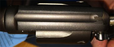

1944 Victory Revolver
Friends,
I have been offered this revolver.
S&W Victory, Serial Number V 675448.
The first posting on this Victory forum gives this information:
1944 –
Start: (approximately) V490000.
Victory production reached serial number (approximately) V740000 by year-end 1944, with few changes made in features and finish.
First question:
What does "C of K" refer to?
What does C.H.D. refer to?
Is there anything remarkable about this revolver?
I have been quoted a price of $560.
This seems high to me, but I do not follow S&W prices.
I attach iPhone images for your information.
MQP

It's not CHD, it's GHD - (Col) Guy H. Drewry, commander of the Army's Springfield Ordnance district. I'd guess "C of K" might mean "City of K____" possibly a former police gun. SN would make it from about September 1944. Not too much detail given in pictures to assess its worth, but the price strikes me as being on the high side. At least it's in .38 Special, and finish looks pretty good.
DWalt,
Thank you.
I do appreciate the clarification of the initials.
The finish is good, but not great, with light scratches here and there.
