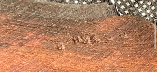

I am posting a few more pictures with the grips off and now I have MORE questions on what the other stampings may mean. This revolver was acquired last weekend and hasn't been cleaned yet.
The inside right grip does have the correct S/N but very difficult to read. The first 9 is almost 2 numbers away from the 2nd number. The stamper must have had a long day I'm sure!
On the Left grip frame on bottom right is the S2 number that was stamped on the crane in my previous post.
The R.H. frame around the grip pin shows a 47, H, V. And to the middle right is a 4. Then up at top right is another V.
Since we decided this firearm is "PRE" victory does anyone have an idea what the "V" stamp referenced along with the other stamps of 47 H and 4?
Thanks in advance.
Dean

What did you use to generate this pic? Thanks
MCB 66.
I used a filter in Adobe Photoshop 7 called EMBOSS. I've used it in the past when a stamp like what was in the wooden grips, is not clear. You can also DEBOSS it too. So indented or raised. Sometimes it helps.
