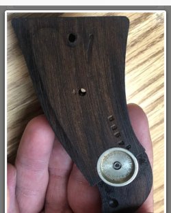

Usually the grips will have a serial number. This pair does not. I think if they came on a gun they have a number and if sold as an accessory they do not. Also no patent date. The early grips did not have that. My gun is early, shipped December 1935, so I like it that they have no number and no patent date. Would rather have no number than a wrong number. Think I paid $750 for the grips around two years ago. Maybe that will help you feel better about your purchase.

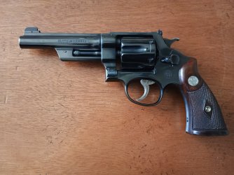

Not necessarily, David...A recently acquired K-22 Outdoorsman came to me with the pictured unnumbered Magnas which I originally assumed were post-purchase add ons...I've been told the patent dates did not appear on the early Magnas following their introduction in 1935...After lettering it, Don pointed out that the invoice indicated shipment of multiple Outdoorsman K-22's both with and without Magnas...It was also pointed out to me by another that in the absence of S/N's on the invoice to indicate which is which, it can't be determined which had the Magnas and which had the service stocks...But since the original purchaser from 1937 is not here to verify it, and since the fit of the stocks to the frame is so good, I will proclaim them to be original...Those wishing to challenge me, please meet me behind the barn after supper... ;) ...Ben
