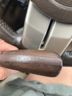

The backstrap had an interesting stamp on it - "S.H. AND P.W.C.". Sounded like perhaps a railroad gun? Nope, some more research shows that referred to our home state of NC and meant 'State Highway and Public Works Commission', which was the entity of NC State Highway Patrol fell under in its early days, being founded in 1929. The NCSHP stayed under that department until 1941.

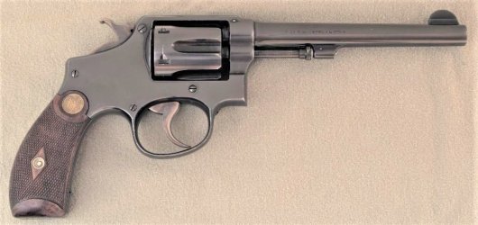

Grips on the gun appear to be WWII Victory Model grips, very worn. No checkering at all.
My buddy is interested in getting OE type grips on it - and told him I'd check.
I'm guessing Walnut diamond-checkered without a grip medallion? Is that about right?

OK, finally got around to loading pics, and now I'm questioning if that really is a 'G'.
Buddy lives many miles away, I have not seen this gun in-hand.
If it's NOT a 'G', suppose it could be a
6' or and '8', putting it as a different model variant.
Enlarging the pic of the butt really helped these old eyes. See what y'all think.......
Also a pic of the back strap.
Thanks!

I would say that is a number, not a letter. Have him look under the barrel and at the back of the cylinder as older models should have the serial stamped there as well as on the butt. At a guess from the picture I think that last digit is a 6 but there is a lot of wear so check the other locations.
It's a 6 digit serial. Last number could be a 6 or 9. It likely shipped in late 1930 or early 1931. The grips could be WWII Victories or 1920's service grips that have had the checkering sanded off. Original grips would have been walnut checkered diamond with round top and a silver medallion.
