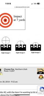

Which is best? This may be easier with a picture.

The sight picture is always the same. Keep the top of the front sight even with the blades of the rear sight, and centered in the notch.
The position on target depends on the purpose. For target shooting, the top of the sight is held at 6:00 on the bulls eye, with the elevation set to place the shots in the center.
For hunting and combat, the sights are adjusted and the top of the sight is placed on the intended point of impact (ie center of mass), at a pre-determined distance (typically 50 yards). At other distances, the hold over (or under) depends on the estimated distance, and experience.
This is picky, but what you just described is sight alignment. Sight picture is where the properly aligned sights are placed upon the target.
Right or wrong, I seem to get the best results with red ramp front sights by properly aligning the sights and using the very top of red ramp for point of impact which is similar to sight picture #3. This is easier and more repeatable to me than trying to identify the black top of the ramped sight while focusing on the target. Not saying it's right or wrong, but it works for me with older eyes.
I've always preferred a six o'clock hold. Or "pumpkin on a stick" as we taught the kids in 4H air pistol class.
Dead on hold or stick it where you want to hit, is best for hunting and defensive work or practicing for same. Hard to use a 6 o'clock hold on a deer or offender. It becomes Kentucky windage of sorts. Put the front sight (top) where you want to hit. Where appropriate, concentrate on the front sight not the target or the rear sight.Defensive situations require target/threat identification and scanning so the front sight is usually up on the target but it is not the focus. You can still see the front sight on target, but not like you would if shooting in a PPC competition. Muscle memory will likely make point shooting effective at close range.

For me, I find that sights without dots work best with a "six-o'clock" hold.
However, S&W semi autos with dot sights, seem to want to shoot to point of aim, by putting the "dot" on the bullseye.
Like I said, for me.
John
I like a 6 o'clock hold for shooting NRA style targets, but JohnHL pointed out, S&W pistols with 3-dot sights seem to be regulated for a combat hold in which the point of impact will be at the top edge of the front sight or even within the front sight's dot when the sights are properly aligned.
I was taught, "Light bars and level" when shooting. This refers to there being equal amounts of "daylight" on both sides of the front sight when centered in the rear sight notch, along with the top of the front sight being level with the top of the rear sight.
I normally utilize a "6 o'clock hold" when shooting 25 yards. When getting close, 12 yards and in, I aim center mass. This is not "the way", it is "a way". Lots of good information here. Find out what works for you and drive on.
