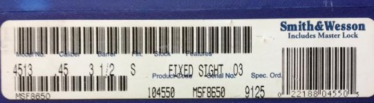

Now I have a question for you. Does yours have night sights? Mine does and I wondered about the number 03 after the fixed sight words on the box.

I can't remember if I even have my original box, nor what sticker's printed specs listed for mine, but the barrel length of the 4513TSW, 457 & 4516's were 3 3/4", not 3 1/2". Not the first time I've seen mistakes printed on a factory box sticker, though. I sometimes used to wonder if the people editing the content of the printed box stickers actually paid close attention to more than just confirming the serial number. ;)
. . . Now I have a question for you. Does yours have night sights? Mine does and I wondered about the number 03 after the fixed sight words on the box . . .
Not night sights. The book says the pre-rail 4513TSW came with 3-dot fixed sight but I don't know enough to say if they're the later 3-dot with the Novak Lo-Mount Carry rear sight version. Can you tell from this picture?

The "03" on the box label usually indicates an example made to fill an LE order (50 guns minimum) after the "official" end of production for that model.
