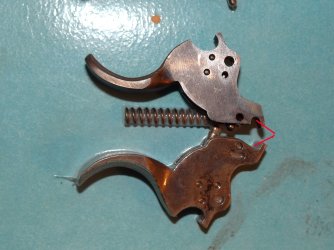

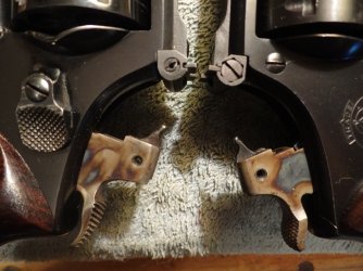

I find it interesting that your gun has a SA hammer with a non-target trigger, which I assume is a DA trigger. The SA hammer/trigger was introduced in 1961, so there is no way yours came from the factory with a SA hammer. I have the earliest known 14-1 SA shipped on June 28, 1961 that letters as such. The SCSW 5th Edition states that SA K-38s spanned the 14-2 through 14-4 models, which is incorrect. I have documents for 3 different 14-1s that were shipped as SA only guns. I am sure there are more.
Here are a couple of pics, one showing a SA hammer side view, the other showing a SA trigger next to a DA trigger. I assume your gun has had the DA sear removed? Also a pic showing the difference in hammer throw between a SA (with both SA hammer & trigger) and a DA. The SA throw is shorter, creating a faster lock time.
