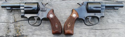

Since it's a 5-screw .38 Chiefs Special, it's not a "pre-Model 36." The Baby Chiefs ran from serial number 1 through 45962 (there were some later Airweight models in that mix, too). The "later" model we call the "Model of 1953" because it had a 1/8" longer grip handle, a longer, oval trigger guard, and only 4-screws -- eliminating the screw in front of the trigger guard (see attached photo).
