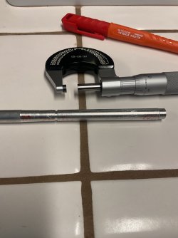

Trying to make a range rod while learning to use the lathe. Checked my first attempt on 8 different barrels - they varied from .342 to .350! Most came in around .347 so now I’m a bit confused.
As expected, the largest was the oldest, a lemon squeezer. The tightest by far was a 686-6 barrel.
How much clearance is acceptable? You can definitely feel a little shimmy with just a bit off. A .342 rod in a .347 barrel feels like a hot dog in a hallway.

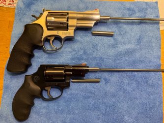

I just bought brass rods of various sizes and cut them to the desired lengths. I haven't needed one in over 35 years but keep them in the range bag just in case someone else does. I never felt the need to have a perfect fit in the bore.
According to my notes Brownell's service rod is 0.3445" and their "match' rod is 0.3458" Probably got that from their website but might have been someone like you who measured and posted.

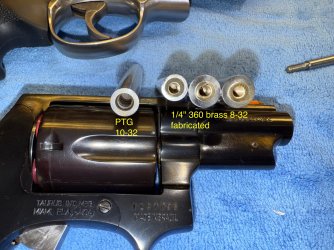

When I wanted to fit a replacement stop for a '42 M&P I bougt some 0.3437" dia. A2 steel rod. Close enough to .344 and it could be at my door the next day from McMaster. Then I checked where the rod contacted in each chamber and that confirmed what the replacement stop needed to do. Goal was for the rod to go into each chamber with an empty (spent) shell in each. This was revolver that had needed a yoke realignment. And one fix then lead to another fix needed...
To check cylinder alignment

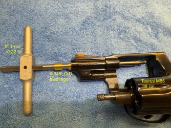

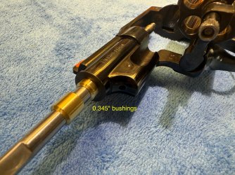

It is a matter of symantics......I think most think of a "range rod" as squib eliminator at the range, precision tool diameter not relevant to the task. Others, think of range rods as precision barrel bore-cylinder alignment gages when evaluating revolver accuracy issues.
I have no faith in a rod for cylinder alignment. It's bore diameter which allows the chamber to be out of alignment by as much as the groove depth. Simpler to light the bore and look.
