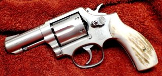

The 10 & 64 models have shorter cylinders and thus the barrels set back into the frame. As others have said, a .357 magnum offers a little more versatility in ammunition choices. My elk stag stocked 65-3 and 65-5 are loaded with 180 grain hard cast Buffalo Bore cartridges. The 64-3 is loaded with 158 grain FBI loads given to me by a retired FBI special agent I delivered mail to.
