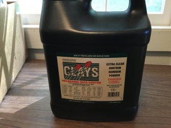

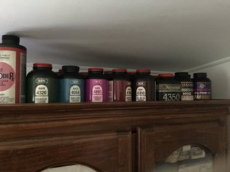

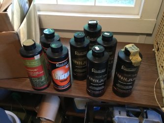

I have an opportunity to buy a reloaders estate there is a fair amount of powder the powder was moved from climate controlled to an outside shed a yr ago where its has been exposed to to temps from below freezing to 120 degrees. I know ill have to shoot this stuff across a chrono to check its true consistency and viability. But do any of you have experience with powder that has been stored like this and what is your opinion on its viability or lack of?

\Those containers of powder I will pretty much guarantee 99.9% all good I MR powders are dated on the containers with the lot numbers. The only ones to really worry about would be the IMRs flake powder will mostly never go bad As far as the IMR..sniff the opened ones...smell like ether..they are ok. I still have about 6 or 7 pounds of WWII surplus 4831 that I still use...stored in unheated/cooled building since the 1960s...and stilluse Hi Vel #2 from yjr late 30s...2400 from the 50s
