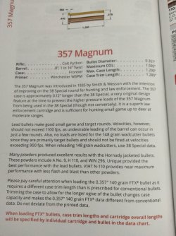

The newest Hornady manual i have is the 9th edition. For the 357 mag and 125 gn xtp, the max charge listed is 14.5 gns AA9 for 1400 fps from 8 in Python using Win wspm primer.
While older manuals have lots of valuable info, am one of those trusting the newer manuals more (at least as far as a reloading manual can be trusted)
I have access to the digital 11th edition. The data is the same as the 9th. 14.5 grains of AA#9 at 1400fps from an 8 inch Python.

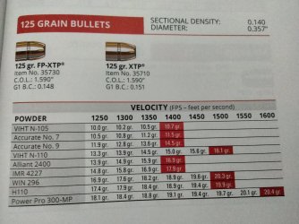

I have the Hornady 11th edition max load for a 125gr Hornady XTP or FP-XTP with Accurate #9 is 14.5gr for 1400fps. Best max is 1600fps with Power Pro 300 MP 20.4gr. 2nd Best max loads are with H110 19.9gr, Win 296 20.3gr, VIHT N-110 16.1gr. Those all gave 1500fps. Send me your email address I'll send you an image of the page if you want.
Thanks, but I don't have any of those powders. I am also trying Unique, 2400, and CFE-Pistol with that bullet.
