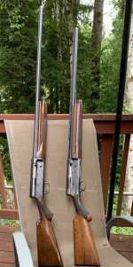

I have one of each, Remington M11 20ga and Browning A5 12ga. Hand me downs from each grandfather. Both are essentially identical except the A5 has the magazine cutoff and rib. To feed lighter loads reliably you need to make sure the magazine tube under the recoil spring is lightly lubed and the friction rings are properly configured for the loads being used. Plenty of YT videos on how that’s accomplished.
