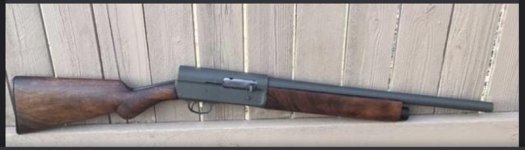

I have both a Belgian Browning A-5 and a Remington Model 11. The Browning is a vent rib hunting gun, the Remington is a former police evidence gun that had seen better days. I stripped off its coats of bbq grill paint, cut it down to 18 inches, and refinished it with a can of Brownells do-it-yourself parkerizer. Its a great gun, and it goes with me on road trips, stuffed full of 00 buck.

Ya I was reading up on the HX. during the war years REM manufactured A5 as well as Model 11's during Nazi occupation of Belguim, there were some parts cross overs as well. The stocks are hard to find...every forearm has cracks in em it seems. Not all but most. Mine are in pretty good shape.
