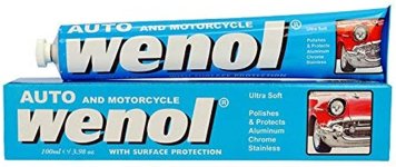

Blue Wenol is made in Germany, so it should be available in Italy.
GREAT Stuff!
Wenol Metal Polish Blue Tube (Ultra Soft, 100 ml.) - Highway Shine Company
