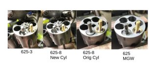

Revolver Cylinder Chamfer Question
Geeko
Jul 14, 2008
9
3
I am trying to figure out what going on with the SW 625 revolver to chamfer using the chamfer tool and pilots from Brownells. Brownells website says to use the 45-1 version for the SW 25 & 625. Both Steel & Brass pilots are the 45-1 ver.
The replacement cylinder was from a repair job S&W did 6 months ago prior to founding out the pilots did not fit the orig cyl that S&W sent back, but the pilots fit with the replacement cyl.
What am I missing?
