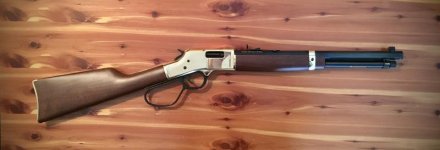

Light, Fast and don't need much cleaning.

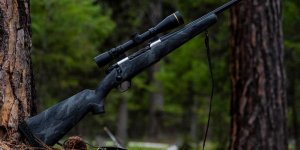

Here's a picture of what Wby's newest gun, the Backcountry Ti, is capable of.
Posted on Adam Weatherby's facebook:
This was shot with a 6.5 Wby RPM in our underground 300 yd range by one of our engineers with one of the first prototypes last spring. With these kind of results, we knew this new cartridge was gonna be a keeper!
Yes, perfect lab conditions but come one... that's awesome performance right there.
I love that they implemented an underground range... just like Roy sr. did in his shop on Firestone Blvd shop in Long Beach, CA. But that was only a 100yd range.
