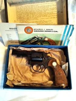

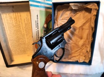

I actually have a Rossi Model 68 3 inch .38 special that I bought 35 years ago for $100 in a pawn shop. The shop owner had about a dozen of them in the case, all of which had been traded in from some South American police department and imported for sale. The bluing was about 10%, but the gun itself was fine.
I kept it a few years and gave it to my mom when my dad died to keep in her nightstand. When my mom died, I got it back and a couple of years ago, we had a tropical storm on the way and I wanted a project, so....I stripped it down and cleaned it of all oil...Got it scalding hot in boiling water and put multiple coats of Brownell's Oxpho-Blue on it...Let it dry good and I oiled it up and gently re-assembled it.
I got an original box and manual on Ebay, and now it looks so good, I don't want to fire it to scuff my "professional" bluing job up..:rolleyes:
