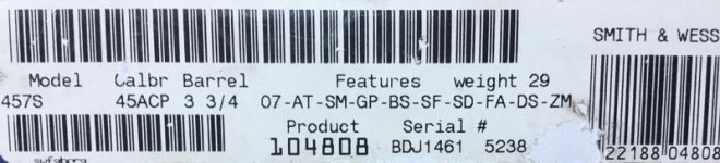

Hopefully one of the pros will clarify, but I was under the impression that 457s were made 1996-2006 in 4 varieties:
Original Blue with left only safety SKU 104804 (1996-2006)
Two Tone Blue over Silver SKU 130120 (1997 only??)
457S Silver (stainless?), SKU 104808 (beginning 2003)
457D Blue, Double Action Only (VJB02xx not Double Strike SKU 108179 per SW and Mfg Date 6/1997)
And as far as I knew, all 457's were the same dual spring setup as the 4513TSW and the late 4516-2 (1993 and up) with the smaller diameter recoil guide rod and smaller hole for the guide rod at the end of slide.
457D Blue, Double Action Only (unknown SKU and dates) (circa 1997).
And as far as I knew, all 457's were the same dual spring setup as the 4513TSW and the late 4516-2 (1993 and up) with the smaller diameter recoil guide rod (though plastic) and smaller hole for the guide rod at the end of slide.

No idea on numbers, but I'd guess a few hundred total. No mention of it in the SCSW at all. If you have the box I'd be interested in the Product Code.
I dont have the box but a query to SW for my 457D VJB02xx gave Product Code (SKU) of 108179 and Mfg Date 6/1997. It is NOT Double Strike Capable.
