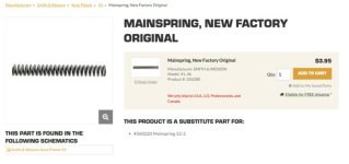

I've been calling around to find new main springs. The Tech Support person at Brownells looked all over, including interchange parts lists, and found only one - the mainspring from the M41 is listed as compatible with the M52-2. I ordered two of them.
Am I correct in thinking that the mainspring is the most likely culprit?

For anyone else looking for a mainspring, I will copy the posting from Numrich, showing that their spring for an M-41 is appropriate for the M-52:
